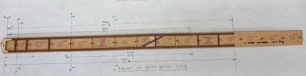

Let's talk about the front/forward spar caps on the left main wing spar.
- The inner (fitted to spar web) upper and lower caps start at the root and are 131-3/8" in length.
- The outer (fitted to the inner cap) upper cap starts at the root and is 102" in length.
- The outer lower cap strip starts about 34" from the root and is 71-1/2" in length.

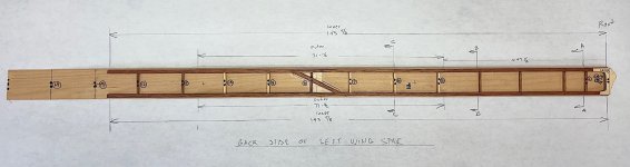

Now for the back/aft spar caps on the left main wing spar.
- The inner (fitted to spar web) upper and lower caps start at the root and are 143-5/8" in length.
- The outer upper and lower caps start about 47-1/2" from the root and are 71-1/2" in length.

Section A-A (through the second nose rib location) is correct because it shows inner and outer caps on the upper front side of the spar at A-A, inner only lower cap (with the overlapping 1/8" spacers), and inner caps ONLY on the rear side of the spar at that wing station.
Section B-B (through the fifth nose rib location) is correct because it shows inner and outer caps on the front side of the spar at B-B (the inner and outer lower caps start just inboard of B-B) and inner caps ONLY on the rear side of the spar at that wing station as with A-A.
​Section C-C (through the seventh nose rib location) is correct in showing both inner and outer caps top and bottom at that wing station.

In terms of bill of materials, you'll need 4 x 143-5/8", 4 x 131-3/8", 6 x 71-1/2", and 2 x 102". This can be gotten out of 13 pieces of 144" (12') 1/8" x 1" cap material.
Here's the model sitting on a quick sketch I did. Do not use my sketch to build from - use it to better understand your drawings and build as Bob designed it.
Click image for larger version  Name:	Forward Side Main Wing Spar Patrol.jpg Views:	0 Size:	313.5 KB ID:	99842
Click image for larger version  Name:	Aft Side Main Spar Patrol.jpg Views:	0 Size:	328.6 KB ID:	99843
