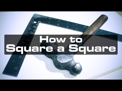

....I didn't think making a square really square was possible...but this guy has a technique that can turn your run of the mill building square into a machine shop accurate tool....quite amazing to behold...

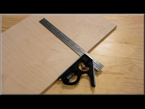

Another good video to check your combination square....I would use the method as shown in the above video to check accuracy by doing a parallel line test..
