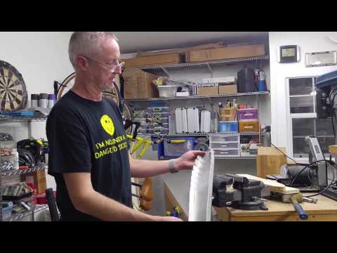

      This video features a builder forming the bull nose of the rib....The rib in the video has the nose shape different then shown in the plans above,,it looks more like the factory ribs...,its up to you decide your route to do this....
