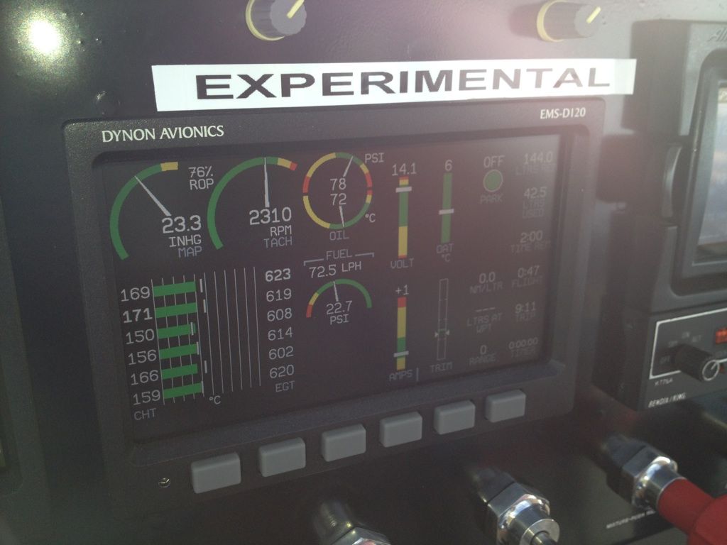

Here's a photo from a high-power cruise (75%) with the cowl flaps closed:
To save you the mental math, those CHTs are as follows, we don't have any other vents or outlets, just the tunnel:
#1 | 336.2 | oF |
#2 | 339.8 | oF |
#3 | 302 | oF |
#4 | 312.8 | oF |
#5 | 330.8 | oF |
#6 | 318.2 | oF |
