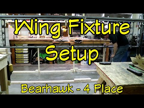

                      I really like this setup for a wing jig, I'll probably do something similar...
                      https://www.youtube.com/watch?v=EP_j...VyrIC&index=10
