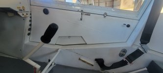

I may be the only one but it seems like when I fly the Bearhawk 4 my left arm above the elbow gets chewed up by the J-shaped latch for the window. Came out bloodied a few times...Takes the fun out of flying......20260714_154406.jpg
I may be the only one but it seems like when I fly the Bearhawk 4 my left arm above the elbow gets chewed up by the J-shaped latch for the window. Came out bloodied a few times...Takes the fun out of flying......View attachment 102325

Verbal description, 1.5 x .125 AL angle cut up to look like pistol, barrel forward, handle down is the latch. Lift / pull back on barrel to rotate handle to point forward, allowing window to push out….

Pictures appreciated when able...Thanks
The factory windows that I have experienced move the j hook forward to a location equal to about your fourth screw, counting from the front. This moves it out of the arm travel area. This is a mod that you could do to your existing window but it would involve welding and painting.
