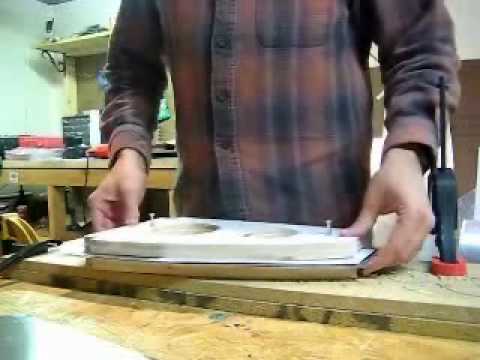

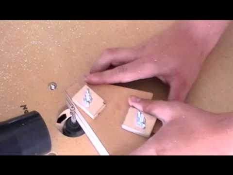

      question #2..from my experience...cut the rough rib out(bandsaw/snips)...router it out if you want with a form block to finished size...or cut it out with snips(more finishing to do but you can just use a cardboard template to trace your parts out on the sheet)..using a router gives you a better edges with less finish to do on the part..but you have to make wood templates for the router to follow...or use a fly cutter to make your holes(no template needed)..
      this video shows sonex ribs cut out with the all router method...but the concept is the same..the video does not discuss climbing cuts...desert bearhawk has a video on router usage and what the climbing cut on a router means...
      question #2.5..it depends how you are going to form your lightening hole flanges...if you are using a press then forming the hole flange first is easier with a flat rib to slide under the press...form your hole flange and then do the edge flange...if you are doing the bob stick method I dont think it matters what you do first...
      Chris from Milwaukee has a great rib party thread on here that shows his form blocks with cut outs to do the flange first on the press...maybe hell post a link if he sees this...or ill post it here when I come across it again...

                  Near the 2nd half of this video the builder shows how to router the ribs without a router table....but.....you have to keep the router flat to the surface...or you will put a groove into your rib template and your metal rib...
                  The router table makes messing up hard to do....but this can be done without a table if you are careful ......
