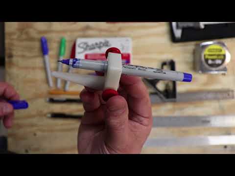

              Originally posted by BillSchmanski View Post
              Can anyone recommend a good home-study aircraft sheet metal course? I am having a hard time finding something along those lines. It is going to be a while before I can begin working on my Patrol plans and I want to make sure I have my work environment set up well and improve my methods before I start in. I have a great A&P and IA who can evaluate my work if somebody can recommend a course. Thanks.
              This video series is actually what you do before you touch the metal...I recommend this to help you layout out your parts...different plane but same concepts..
