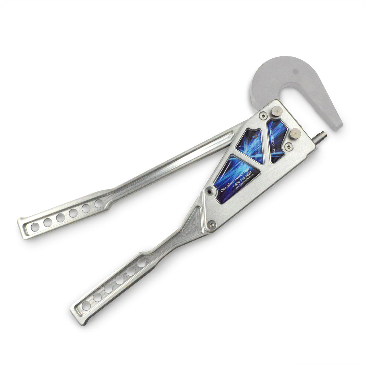

Cleaveland came out with this right after I had bought my Tatco or I would have got it. A little pricy but it really is easier to operate. And it uses the same yokes as the pneumatics if you get one of those later.
Lightweight hand squeezer for dimpling skins and squeezing rivets in aluminum sheet metal construction.

That is a fine looking tool and looks worth the money if the specs are true.Originally posted by DRLPatrol View PostCleaveland came out with this right after I had bought my Tatco or I would have got it. A little pricy but it really is easier to operate. And it uses the same yokes as the pneumatics if you get one of those later.

The Cleavland Squeezer has a mechanical advantage through a cam mechanism that is worth the extra price in my opinion. It significantly reduces the force needed and results in faster operation due to less fatigue. And their dimple dies are pretty sweet as well. I used this tool a lot prior to skinning the wings.
I have the Cleaveland. It's a really nice unit. Kinda weird to squeeze with that much mechanical advantage once you've gotten used to a traditional squeezer. The yokes are expensive though.Originally posted by Bearhawk535 View PostThe Cleavland Squeezer has a mechanical advantage through a cam mechanism that is worth the extra price in my opinion. It significantly reduces the force needed and results in faster operation due to less fatigue. And their dimple dies are pretty sweet as well. I used this tool a lot prior to skinning the wings.
