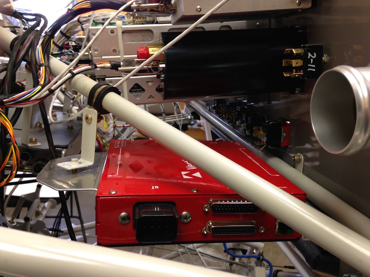

              Here's how I mounted the VPX-Pro. Reach up under panel and undo one AN3 bolt and it hinges down. If you want to remove the unit then just slide hinge pin out.
              Sorry for the sideways pics, don't know why that happens.

                Very cool, aerolite! Thanks.

                    Z, I like the idea of using piano hinge for one side and a bolt to hold the other, nice and simple. If you mount it too far away from the panel like some of the VP pics, you might want to consider running a patch cable to an easily accessible location such as the glove box for maintenance reasons. For those who use avionics other than the big "G" you might want to do the same. Most Garmin use an SD card on the front for software upgrades. I played around with the G3x touch at osh last summer, it is a pretty sweet unit. I would go with the remote mount com and audio panel they offer, it would really clean up the panel. I am planning on using my handheld for my #2 radio wired to ship power with a real antenna.
