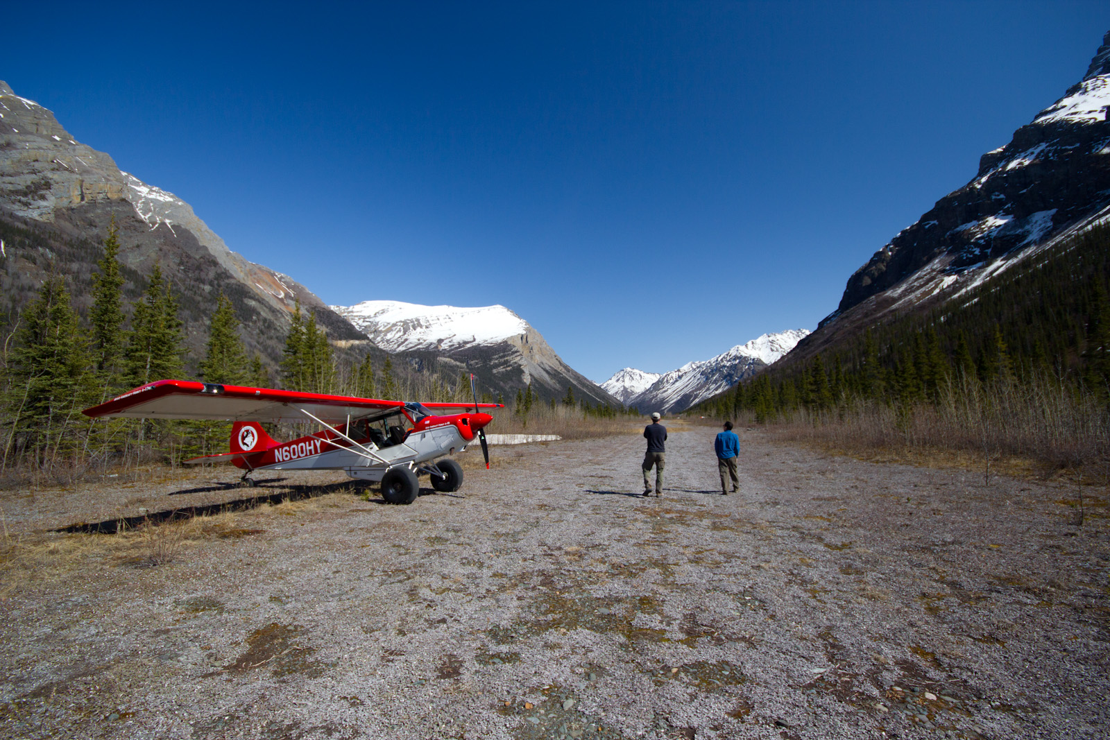

      Great Pictures! Thanks. I have aux tanks for that reason. I do think I need bigger tires. I have 7.00x6 now. I think I'll move up to 8.50x6. The most bush like flying we will probably be like the runway in your second picture.
          That's Jake's Bar on the Chitina River. It's much rougher than it appears with these cobbly teeth-rattling rocks. The 29x10 Air Hawks are a good long-wearing solution shy of full bushwheels, but expensive for the initial buy. The Goodyear 26" are slightly larger than 8.50x6 I think. Battson is running those. We were on 31's and it really made every surface easy on the airframe.
          Peavine Bar is another great spot that is pretty smooth save for a few places. Some people question the necessity of big tires but I'm of the opinion that the loss of speed and the expense are worth the stress savings on the airframe.
