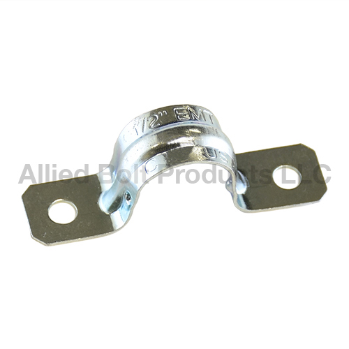

                    You could always avoid that welding with a simple bracket:
                      True but who would I look at in the mirror?
