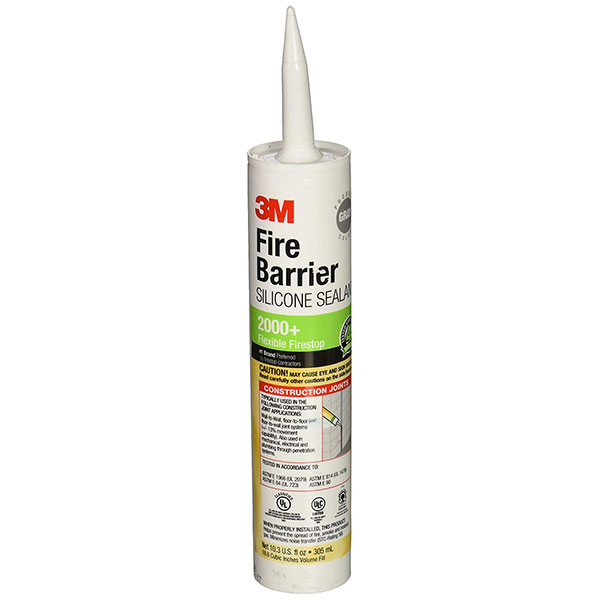

                    I'm with Battson; the gaps are so minute, I didn't worry about them. On a previous build, I used a 3M fire sealant caulk:
                    3M™ Fire Barrier 2000+ 10.3 Oz   For sealing or joining seams; it is applied like standacaulk but will expand under direct flame to insulate. Flammable.
                    This stuff would do what you're trying to achieve.
