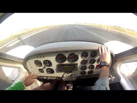

What its like to fly behind this sort of Twin
