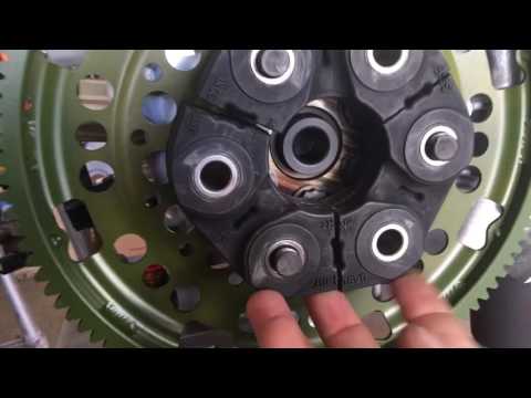

                        Torsional vibration happens on all engines, and the only way to truly dampen it out is to have the engine vibrate against a heavy spinning mass that is difficult to accelerate and decelerate. In a car this is the weight of the vehicle which needs to be accelerated and decelerated through the drive train.
                        The problem with torsional vibration on an airplane is that we don't have a heavy spinning mass, instead we have a light weight tuning fork called a prop. If you have the torsional vibration pulses at the same frequency that the prop resonates at (or a harmonic of it) then you are effectively tapping on a tuning fork at it's resonance frequency, and the result is rapid failure.
                        The rubber donut can change the resonance of the system and dampen the pulse amplitude, but unless it's very finely tuned for the engine, induction system, prop, temp, and load, it can't totally remove the torsional vibration. It simply moves the frequency away from the resonance frequency of the system so that you don't hit a harmonic and have everything fly apart.
                        A sprag clutch does not eliminate vibrations completely, it can remove the engine induced deceleration portion of the vibration, but it surely continues to tap on the clutch every time a piston goes through it's combustion stroke. I suspect part of the reason the yamaha works well is because it's a very high RPM engine. There isn't a lot of time for things to decelerate before we are back on a combustion stroke due to the 9k+ rpm.
                        Just like any other system that has torsional vibration, the answer is very plainly to test to find the frequency and amplitude of the vibration, then more testing to see where the system resonates. If the system doesn't resonate in any frequency between idle and redline, then you are good, if it does, then you placard to avoid that rpm.
                        Because the resonance frequency is determined by the system, the testing above would need to be per prop, and honestly it may change with induction or ignition system.
                        The point is that the yamaha seems to work, and many people are having success with it, but unless you know where your specific combination resonates at, and know that you aren't operating in that range or a harmonic of it, you are a test pilot. Saying it doesn't vibrate is not true.
                        Before I forget, it's important to note that these engines are geared down from the factory with an internal chain. By the time the power hits your prop, you have two gear reductions.
                        I think it's an interesting setup, and I think that more and more people will try it and find where it does and doesn't work, but we haven't completely arrived yet. I suspect Steve is really good at engine out landings for a reason, and I'm thankful for his willingness to be a test pilot and figure out what works.
