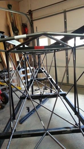

              This gallery has 13 photos.

                To get to the specific original question about whether Mark's tubes fit closer than the VR3 tubes, I can't say, because my tubes came with the weld beads included. I have done a little tube fitting before, and I have also been to visit the factory and have seen a fuselage in the jig, and I was impressed with the tight fits that the workers were able to produce. They aren't using a fancy CNC machine, but they are absolutely using craftsmanship and tooling. It is not a low-skill facility.

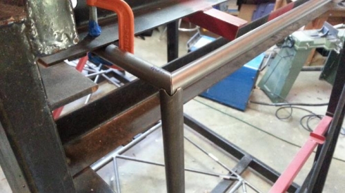

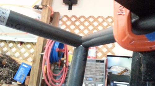

                          I have also attached a photo that I took of a tubing joint in the jig prior to tacking, as I was walking by the jig. There is nothing special about this joint, and it wasn't made for the photo. Note that there is a semi-circular gap where the red tube joins the yellow tube, but that is supposed to be there. Zoom in and look at the fit of the unpainted tubes to the yellow tube.
                          Having a discussion about the quality of the factory work is productive, but regardless of how good it is, I have to wonder if you are putting too much emphasis on the tube joint fit. That alone isn't going to assure you a straight fuselage. There is plenty of tolerance in welding these parts- I recall reading up to 1/16" somewhere. Your filler metal is going to take up any inconsistencies in that range, and the structure is going to be moving around due to all of the expansion and contraction forces anyway. The most reliable and accessible way to get a straight fuselage is to order one that has been welded in the jig. You might get Mark to quote you one of these- the price might be more reasonable than you'd think when you take into account the price of tubing. The tubing kit ships easier, but it is going to take a serious investment in time and tooling to get a tube kit into a fuselage. In case you are afraid of missing out on the opportunity to weld, if you get a bare fuselage with no tabs, you'll still have plenty of welding to do- you'll just not need to be concerned about alignment of critical components.
