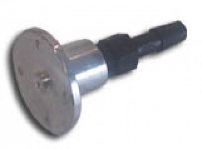

    Does it matter what type of static port I install?
    I been looking at this one.
    Static Port Aluminum 15160 Aluminum static port for mounting through 1/4 inch diameter hole in the side of the fuselage.

    I used that one and found it to be perfectly suitable. I liked that I could use squeezed flush rivets to mount it to the support plates.
    The plastic inserts can become a little brittle over time. If you need to test the static and pitot system periodically, it's worth investing in a good T-connector if you install two static ports, or upgrading the connector if you're only using one (which I would not recommend, two is very cheap insurance!).
    By "good connector", I mean one which is either metal and won't break when you try to remove the tube, or uses screw-up locking system (e.g. nylaflow style connector) so it's easily undone to allow for the system to be tested.

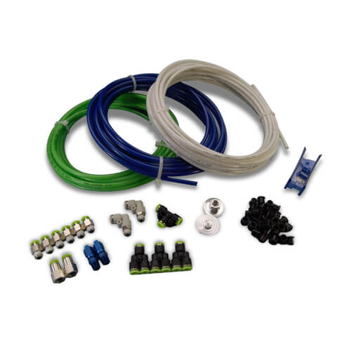

      I got a kit very similar to this. Quality was excellent and enough for the entire project.
      Avery EFIS System Plumbing Kit The fittings capture the tubing with stainless steel retainers. By suppressing the release ring (around the tubing entry port on the fitting), the tubing is easily removed. Within just a few minutes, you'll be
        Thank you. That is really what I was expecting to find but didn't come up in a search for static ports.

            If anyone else goes searching for static ports the best keyword is plumbing kit. I think I am going with Dynon and found this.
            Thanks for everyone's help.
            Dynon Pitot / Static / AOA Pneumatic Installation Kit The fittings capture the tubing with stainless steel retainers. By suppressing the release ring (around the tubing entry port on the fitting), the tubing is easily removed.

                I used the Dynon kit and found it to be very good. It contains everything you need, including a small tool for cutting the tubing and all connectors.
