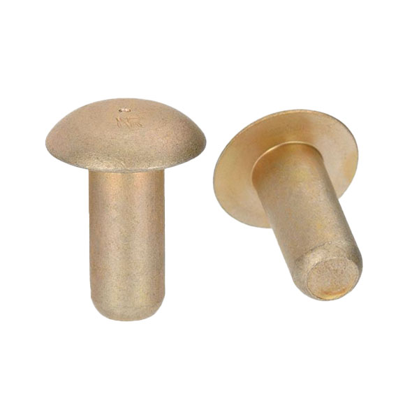

      MS20470A-4-5 Solid Aluminum Rivet ]A rivets are soft. They are fabricated from 1100-grade aluminum and have a tensile strength of 16,000 PSI. AD rivets are fabricated from 2117 aluminum and heat treated to the T4 condition.
      1100 soft are weldable as far as I know. Weldable blind rivets, your on your own other than suggesting any soft composition with an aluminum mandrel. Riveted and pro sealed my tanks and knock on wood, no leaks. No distortion either from welding.

              Thanks for reminding me of SOLID ALUM RIVETS AN470A-4-3 as opposed to AN470AD. I actually have some that I had hidden away to prevent their use in for anything structural.
              The A rivet is 1100 alloy - it is weldable.
              I guess I will get the blind rivet from Aircraft Spruce CHERRY Q ALUM RIVET AAPQ-42
