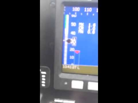

                Flying very lightly loaded yesterday, although not extraordinarily light, I was able to keep flying with full control at down to 29-30 KIAS. I was very surprised as I was sure 33kts was the limit. I have cockpit video proof too
                I practiced a number of approaches and touchdowns at this speed, the weather was perfectly still making such speeds possible near the ground. It certainly makes a difference compared to carrying a my usual safety margin. It would be possible to land a much smaller spot at that speed, but of course there is no room for error and weather needs to be dead calm.

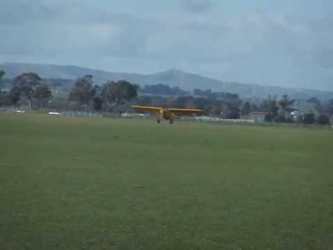

                Unbeknownst to me, I was being filmed from the ground and I happened upon the video by chance:
                  Wow! I would say unbelievable, but I just watched the video. That's some serious "pucker factor" STOL performance. I would never have thought the four-place could fly so slow. Thanks for the video.

                        Haha - I know you believe me, but here's the evidence:
                        It was possible to hold her there steady, for longer than I do in the video, but I didn't like distracting myself with the video on approach to land.

                          Does the video show ground speed? I'd be curious to see how much error your ASI has at those speeds. Most planes start to get pretty inaccurate at such high AOAs.

                            The Dynon AoA Pilot has another dynamic pressure port angled 45 degrees downward on the pitot mast, which uses to measure differential pressure and determine AoA. So that may help their system avoid that angle problem? You can see in the video that the AoA is about 16-17 degrees.
                            In that flight regime I wasn't able to focus on each instrument and compare them carefully, as well as holding the camera and the plane steady. I did look for error briefly and didn't notice any significant difference. It was certainly one of those rare perfect days when you can truly say there was nil wind near the ground.

                              I checked with Dynon about their Pitot design. Their short answer is yes - it's less susceptible to those errors than garden-variety pitot tubes.
                              Some subsequent testing suggests there is at least a few knots of error at very high AoA (16 degrees plus).
                              The error seems to vary depending on the day...
                              So for clarity's sake, all the numbers discussed above should be considered as what they are - IAS.
