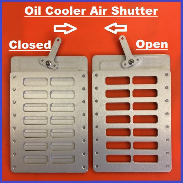

          Then I put aluminum tape in front of the oil cooler and removed little pieces for warmer days. A better option for the experimental crowd is this oil cooler shutter, linked below. Have used that with great success in other planes (all experimental, of course...). Most effective on the front of the cooler.

            Thanks for the great input! It hurts just walking outside in temps like that, let alone trying to fly! I did look at that plate by Anti-Splat and it looks like a good option. I would hesitate to go with that only because it blocks some of the flow even at wide open. Maybe it doesn’t matter, but that’s my thinking.
