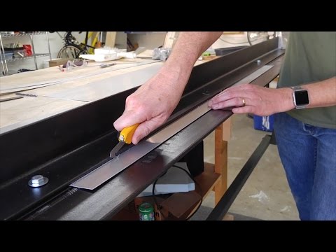

        If you want straight cut, nice edges, no deformation, use a straight edge and an Olfa knife. Make sure your straight edge is clamped down. I used this method when I built my Rv and BH, and it works like a charm.
        i found a video that explains it. Few strokes with the knife and then bend progressively at the cut line. The guy in the video use a brake, but it’s not required.
          mike
          I’ve wondered about those. They appear to be popular in the Zenith circles on 6061. I wondered how it would work on 2024.

            not a problem on 2024....

                I like using the Olfa knife along a straight edge. Those cuts are great.
