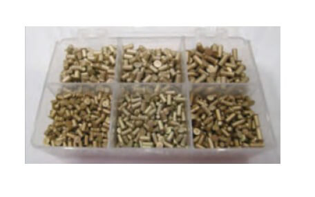

    For the benefit of some builders who are unaware of this...NAS1097 rivets
    I had a couple of problem rivets (tough to access and buck single person) that I didn't seat well and required drilling out. After a couple of unsuccessful repeated attempts the rivet hole for a -3 rivet was too large. These particular rivets were in a dimpled layer of material. I knew I couldn't drill the enlarged hole to the next size and use a standard countersink rivet head in the dimpled hole sized for the original-3 rivet. The solution in this case was to use a NAS1097 rivet. They come in a variety of rivet size. After removing the messed up rivet, I updrilled to #30 (the next size up) and used a NAS1097-4xx which has a reduced size rivet head. It filled the original dimple nicely and with a second set of hands to help, I've got a nicely set rivet in a nice slightly upsized original hole. Happy, Happy! The picture shows the newly installed NAS1097. Hope this saves some worry and fretting over bad rivets. I have continued to learn that there are a variety of "fixes" out there, whether hardware or technique for just about anything with airplane building and repair.

    Is commonly called the opps rivet
      Oops Hole Saver Rivet Kit NAS 1097 rivets are 100º flush rivets with a smaller head.
        I have a very strong viewpoint of NAS 1097 rivets. EVERY builder should know what they are AND have a supply of NAS1097AD3 rivets (as opposed to the -4 that is discuused here) in their inventory for installing nutplates. Get them in lengths of -3, -3.5, -4.
        The small head is countersunk with a about 6 turns of a simple duburring tool in a jiffy and does not penetrate .025 thick alumimum. This is the Indistry Best Practice for nut plate installation.
          I used a bunch of those in .025.
        • DBeaulieu
          DBeaulieu commented
          Yup, used them in all of my approx 400 nutplates (so far)
