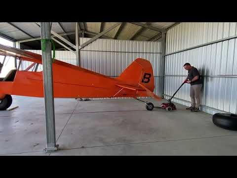

            I saw a tug someone built out of an old snow blower. He claimed it works well, and I don't see why it wouldn't. The blower part was removed and replaced with a tail wheel cradle he welded up. Then you just utilize the existing self propulsion of the snow blower.

              Yes, buy an old heavy snowblower. Preferably with electric start! A few little mods and away you go.
            I just finished one using a really worn-out snow blower. It should have been hauled off to the landfill, but it lives again. Sometimes I feel like the patron saint of lost causes!
            I made the replacement front end with a trailer hitch ball instead of a cradle so I can connect it to my towbar and my fuel trailer. It works pretty good, but chains are a must. There is no way I could move my airplane in the winter without something to help push as the ramp in front of my open hangar has a slight uphill component....and it's covered with ice and snow!

              I cut a mobility scooter in half and added a servoed wheel clamp. As usual it was Graham Johnson's idea originally so I can't take credit for the idea. His one lifts the tail wheel off the ground. Mine clamps the tailwheel. Works well. However current I'm still finding it easier to push the aircraft by myself as long as it's on concrete. Larger tires are needed for off-piste operations.
