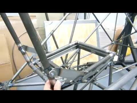

                Rod, do you have any pictures. I'm hoping to make my seat angle adjustable in flight. Having a comfortable seat is a big issue for me, I built head rests that should help on the long flights.
                  I'll be pulling from the concept bellow. Forward hinging with an adjustable stop that sets the back angle.
                  • Sir Newton
                    Sir Newton commented
                    I like it! Simple & Functional. However the design needs a forward stop.
                    Seats that use rollers in the seat slide mechanism generally only work correctly for a few years. The rollers end up breaking & never get repaired.
