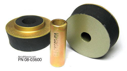

Having a hard time finding rubber engine mount isolators for my 0-360 with a type 1 dynafocal Engine mount. The suppliers I’ve talked with including Vans say the Barry mount isolators number 94011-20 should work. In the pictures you can see what I’m up against. The cup inside diameter is 2 5/8 inches, and the Berry isolator 94011-20 outside diameter is 2 3/4 inches
Im sure others with this engine and type 1 mount have gone through this. Hoping someone has some part numbers for isolators that will work. Thanks
