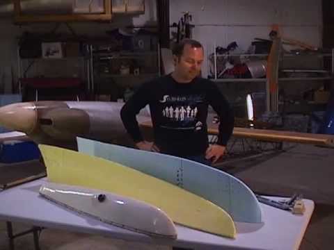

                  I stumbled across a YouTube video today that's about an hour long. A fella outlined the entire process of how he made his Hoerner-inspired wing tips for his Sonerai. Pretty cool stuff.
