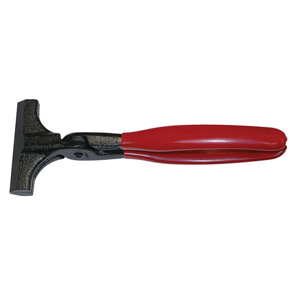

    Hand seamer - just about every toolkit on Spruce has one of these. I've never used one in my life. Any need for this on a Bearhawk scratch build?
    Hand Seamer 04-44 Makes permanent, tight fitting seams. Strong, lasting construction.

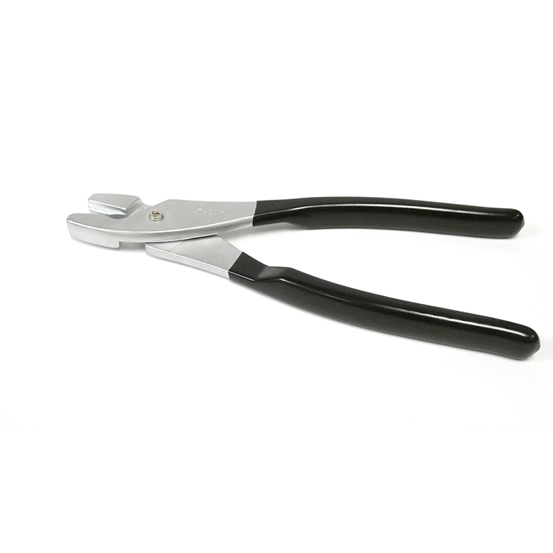

    Fluting pliers - I can see how these can be useful, particularly for the nose ribs, etc. I see they have the plastic-tipped ones and metal ones. I'd think plastic-tipped, if I were to get one.
    Oh yes, great in tight spaces:
    Aircraft Spruce is the trusted source for aircraft parts, pilot supplies, and aviation equipment. Serving certified, experimental, and homebuilt aircraft worldwide.
    I personally don't like those particular pliers because the flutes are too big/wide. I prefer these because the flutes are more compact.
    Economy Fluting Pliers Narrow type fluting pliers are used for straightening out or coaxing sheet metal into the correct shape. This tool makes narrow and precise flutes in sheet metal.
