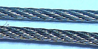

    I thought I saw a post about this awhile back but can't find it. Maybe it was another forum. I have seen several pics of stainless cables that are only a year or two old and have a spot where it is worn halfway trough and I have a friend who had a stainless rudder cable break, fortunately on roll out after landing on grass. (kept it straight with brakes-no incident) I had seen some speculating on why this is and none of it made sense to me. Its time for me to put my cables in and before I install the stainless that I bought over a year ago I thought I would research a bit. After finding the attached article, I'll be ordering galvanized cables and looking for another use for the stainless that I already have. The cheap side of me thought "use the stainless and keep an eye on it" the other part of me, the part that wants to live forever, thought "why take any extra risks-your flying is already bad enough without risking a control failure"
    Anyway, I thought I would share this article in case there are others out there like me who just "know" that stainless is better than galvanized. My thoughts only extended to the idea that if the galvanized coating gets scratched the cable will rust and that may be hard to notice. Clearly there is more to be considered.

    Galvanized on top and Stainless on bottom
