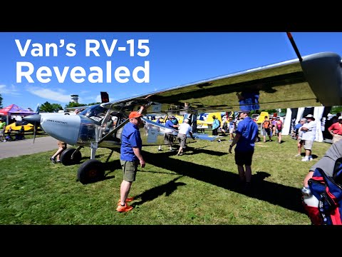

      There is something interesting going with the RV15 stabilator … in a aopa video it shows double sided mini-tabs(I forget the name for these flaps) at the end of the elevator… both up and down at the rear edge … maybe someone with a mind for such things can chime in… did they build the current stabilator too small and this gives it more authority?...its a prototype so maybe its sizes will differ from production...or maybe its a way to explore..what a larger elevator would do without building it..just add these strips
      link to page with many detailed photos..https://dougreeves.smugmug.com/RV-15...ing-Prototype/

      That's a servo trim tab on a full flying stabilizer. The servo tab deflects further upwards as the elevator is raised and vv (opposite to the Bearhawk system). It provides a very nice "feel" to the pitch control. The more the elevator input is increased the harder it's to add more input.
      Looks like a gurney flap across the aft edge of the elevator.
          sorry..I should have been more specific...its the gurney flaps as you mention ..is what I`m referring to...they are opposed with them running on the top and the bottom of the stablator/elevator at the rear edge...ive not seen them used like this...the picture only shows them on top...the video shows the bottom opposing one..you can see it at 4:14 in the video
          • Nev
            Nev commented
            I think you got it right, they increase the control authority if I understand correctly.

          at 4:45 they talk about some of the numbers
          • #54
            Thanks for the vid! I wonder if that right-angle tab on the stabilator is to prevent the dead-band which is present in some of the Piper planes with full-flying stabs?
            It looks like Vans has put a lot of engineering into the gear. There were many comments on this forum about the ruggedness of cubs and Bearhawks over other designs. Perhaps Vans has achieved the “ruggedness” factor after all (it’s a bigger issue than just the gear, of course)
            I’m surprised about the exclusive use of pull rivets. I get that many would-be builders think riveting is hard, but a little training overcomes this trepidation. Pull rivets must add significant cost and are cosmetically inferior. Vans knows how to sell kits though.
            I’d sure like to know wing span, area, and airfoil.
