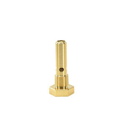

    I used these, they stick down a little less:
    Saf-Air SA18 Drain Valve SAF-AIR designed its line of flush mounted fuel drain valves to be an exact replacement for the Auto Valve F391 line of flush fuel drain valves. Unlike the Auto Valve, SAF AIR valves can be rebuilt. These valves off
      https://www.aircraftspruce.com/pages...h_05-00970.php
      I was looking at those too Jared, however I wasn’t sure that it would clear the tank filter. I’ve got only 3/4 inch clearance between the bottom of the threaded portion and the fuel finger strainer that sits just above the drain valve.
