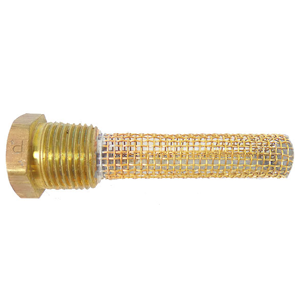

            Spinning wrench has a great drawing….I have no photo that can improve in it. In order the size the fuel tank bungs, consider committing to the hardware that you will use. Each tank outlet will have a finger screen that threads into the bung and receives a male AN fitting. The 3/8” fuel line will take a dash 6 fitting. So take Bob’s Patrol Book, the Tony Bingellis books, and the spruce catalog and make it fit.
            link to finger strainer
            Finger Strainers Finger strainers for fuel tank outlets. Brass fitting has 3/8 inch male pipe thread which fits AN867-3 welding flange, and 1/4
