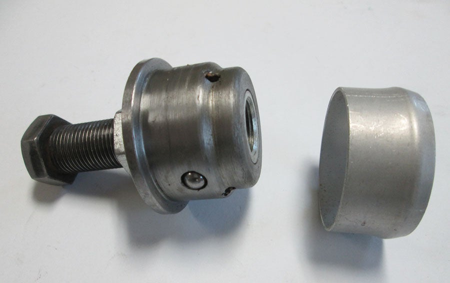

    I used a simple beading tool. One of these I think: https://www.pegasusautoracing.com/pr...sp?RecID=31585
      If you want to DIY it, this is a good option. I have used similar for inter-cooler piping (automotive application) when the tool cost exceeded the amount I wanted to spend.
