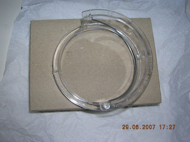

Other options are the window vents. I went with these on a certified Piper I've restored....fuselage is done...waiting on wing parts. Javron Cub sells non-certified that are identical to PMA'd from Univair.

The window vents don't always work so well. My BH's sister ship here in has them, and they are unusable. Perhaps in a slower aircraft, or one with smaller windows?? I can't say why. I have been assured they were a bad idea in his case, and he wished he didn't install them. Certainly when we flew together, it was a hot ride. He said he wished he went with the vent tubes in the wing root.
I am talking about this kind:
http://www.gt40s.com/forum/attachmen...9&d=1199218692
IIRC, the air pressure broke them when full open at cruise speed, or pressed them shut. I don't know which.Last edited by Battson; 05-13-2016, 03:25 AM.
On the circular window vents - I read somewhere that they are limited to opening only below 120 mph... Unlike SuperCubs, this could definitely be a problem in any of the Bearhawk models!
Yeah, they use these window louvre things like the picture above on the old Seahawk helicopters, but they eventually develop small cracks, and then get ripped out in the cruise ~140kts. Makes a really startling noise the first time you hear it, and you wonder if something important just fell off your frame.Last edited by James; 11-26-2020, 04:30 AM.
