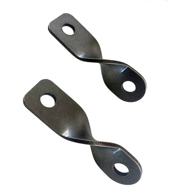

        On another note, where are people sourcing lifting rings and how are they attached? How do they fit with the fairings? And water issues?
        Metal lifting rings are good, but just simple loops of synthetic strap/rope will also work just as well, permanently installed or temporary. Both work.
        That looks like a beautiful plane. Sorry for the accident. I hope it turns out OK.
          What about these? Would they work/fit on the BH design?
          At Univair, we’re experts at salvaging and rehabilitating classic planes with our vintage aircraft parts for sale. You can buy classic aircraft parts here!
          • 500AGL
            500AGL commented
            Yes. Perfectly. (Both altee dodge and univair offer long ones - call and confirm length needed)
          I made my lifting rings out of 1/4x1” stainless strap that I clamped into my vise and twisted with an adjustable wrench. I cut my fairings just enough to get them thru and used clear silicone, seemed to work good.
