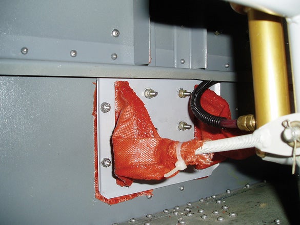

    Chuck Dieterich, DIY, firewall, firewall boots, firewall boot, Zenith, CH-701, Zenith CH-701, www.zenithaircraft.com, steering rod, nosewheel, fiberglass, pattern, rubber gasket, CO, carbon monoxide, carbon monoxide monitor, CO monitor, Sonex, boot, fabrication, silicone, putty knife, plywood form, half-inch plywood form, aluminum plate, 0.040-inch aluminum, silicone-impregnated cloth, cone, mounting flange, nylon tie, steering rod, easy.
